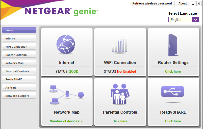

Thanks for the replies, however I found the answer. The OEM Netgear DGN2200 is supported for the ReadyShare, even with the WD MyBook Essential, HOWEVER because I have a DGN2200 supplied by Optus when I was with them, I found out that Netgear customizes the modem/router for Optus. By customize I mean DISABLE a bucketload of features in the router firmware. This means they show up in the router options, but when you go through the Netgear Genie application, they show as NOT SUPPORTED (pictured). Unfortunately this is not able to be undone by updating the firmware as the regular Netgear firmware will brick the modem and make it unusable…

As you can see here it shows up
However, when you press it, it shows as this
I notice your running Firmware v1.0.0.16
looking at the Optus website (with their Firmware)
Optus Firmware v1.0.0.34 was the last one available … and a mystery one v1.0.0.36 which nobody can find
