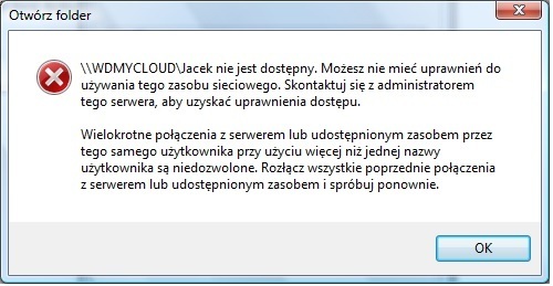

I have two PC’s at home: one with XP SP3 system and another one with Vista Home. I have created an user: “jacek” and one share “Jacek” on the disk and put password, and switched off public and multimedia. Provided full access to “jacek” user.
My idea is to have this folder visible only on these two machines so anyone else at home can access it. So on machine with XP all is fine , I have mapped two folders “Public” and “Jacek” but there is issue on Vista machine. “Public” folder have been mapped successfully but folder “Jacek” cannot be mapped if password is on for “jacek” user. I have got following message:
It tells acces is not allowed.
Many connections with server or shared share by the same user using more than one user name is not allowed.
So different PC’s name etc what is going on ?

The error message is pretty clear.  In Windows, you cannot log into a NAS with two sets of credentials.
If you log into a “Guest” or “Public” share first with no credentials, you will not be able to log into a private share with different credentials.
This is a Windows limitation, not a Cloud limitation.
You must log into the Private share first, and then the public share.

That wouldn’t help as well if you’re already connected to WDMyCloud with a different user. Also placing your outlook data on the Public share would let anyone connected to your network accessing it.
The better solution is:
  1. Windows XP: Create a new account with password eg. “daughter”. You would have to migrate the existing guest profile/data to this new account using the PC administrator access. If you would like this XP PC to auto login without password (think that’s the reason you’re using guest account?), WIN+R →  open: “control userpasswords2” → Advanced → uncheck requires Ctrl+Alt+Delete → Key in the “daughter” credentials.
  2. WDMyCloud Dashboard: Create a new user with password eg. “daughter”.
  3. WDMyCloud Dashboard: Create a new share eg. “family”.
  4. WDMyCloud Dashboard: Assign full access to this new “family” share for users “daughter” and “jacek”.
  5. Windows Vista: Disconnect any existing share drive then logoff and relogin. (optionally it’s better for Vista and WDMyCloud to have the same user/pass for account “jacek”)
  6. From Vista access \WDMyCloud\family using user “jacek”. From XP access \WDMyCloud\family using user “daughter”. Place the outlook data on the “family” share and configure outlook to point to it. You could also do network drive mappings.
Above are the usually setups configured on a small home/business network. There’s much more to cover for enterprise level. Hope it helps.

yes on XP i do not have any password as I use it only by myself.
Currently I disconected all shares on Vista and mapped only my private share “Jacek”
Usually I use only one of two PC at the same time and now it works. If XP is switched off I can use pst file on XP and in oposite. On Vista in fact when I need public folder I will quickly map it for a moment.
So an order of mapping is important as it was written before. Just when I mapped public on Vista private share “Jacek” stopped working :smileyvery-happy:
