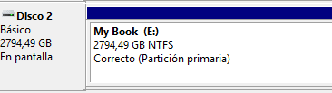

Tengo un WD de 4Tb, pero de acuerdo con Windows 10; solo tengo 3 TB. No es, por lo tanto un problema de unidades de medida. ¿Cómo puedo recuperar el TB que me falta?

Thank you very much for your answer, but it is not a decimal or binary measurament. The box says 4 (four) TB, and W10 says 2794,49 GB; which is, more or less, 3TB

either the box was labeled incorrectly or someone swapped out a 4TB drive for a 3TB

Probably, it is the more plausible explanation because the S/N in the box and the S/N in the HD doesn’t match.
