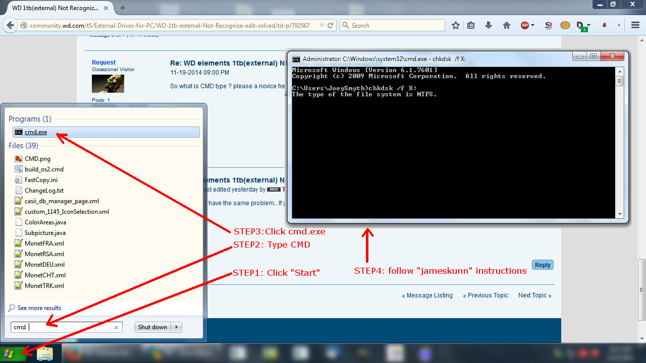

So what is CMD type ? please a novice here so step by step assumes i see whats on the screen ,to to try your fix …

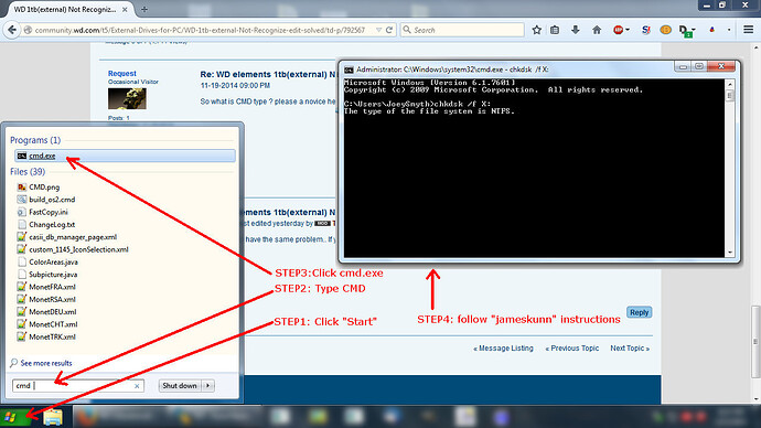

here’s a picture (Win7) to explain what jameskunn did …
jameskunn wrote:

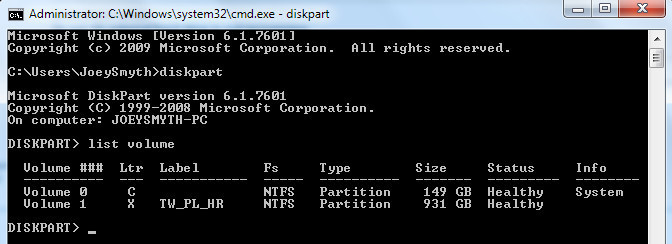

maybe try ?    click “start”   type  cmd ,   diskpart ,   list volume

Hello Musicrab
This is my diskpart screen print
My 1TD “My Book Essential” is already connected to the system, however I am not able to view it in the DISKPART.
How do I proceed further ? What do I do to get my 1TD HDD detected ?
Awaiting your response.
Ritesh
