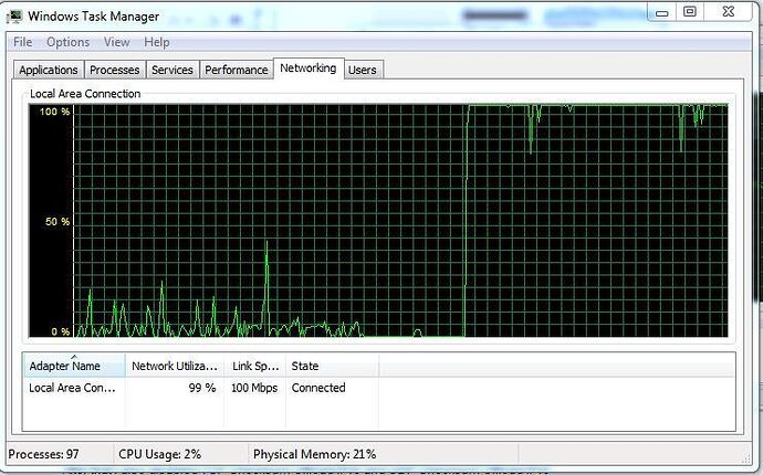

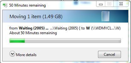

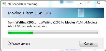

I realize that this topic has been tackled in multiple posts, unfortunately nothing I have tried has worked. I have a MYBOOKLIVE as well as the MYCLOUD connected to the same router. Both these drives are connected at 1Gbps. The computer I am using is running Win7 and is connecting at 100Mbps. I am not concerned with maxing out the transfers only getting the MYCLOUD to be comparable witht the MYBOOKLIVE. I am attaching some screenshots I made of a transfer of the same file from the same directory once to the MYCLOUD, then to the MYBOOKLIVE. As you can see the MYCLOUD is running painfully slow, btw the content scan is currently showing idle and the front light is solid blue. Most times if I attempt to move multiple files I will eventually get a network error that the MYCLOUD can’t be found. In the 2nd network monitoring image the first section is the transfer to the MYCLOUD which I canceled, the second part (where the connection is maxed) is the transfer to the MYBOOKLIVE.
As you can see the connection is maxed with the MYBOOKLIVE but no where near that with the MYCLOUD. I have also switched cables and ports on the router with the same results.

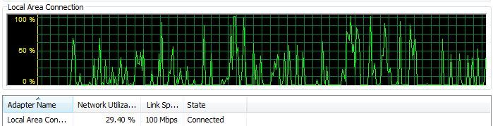

So I took a chance and did a factory restore (system only). The changes were pretty dramatic, not sure what changes I had made that caused the problem. The network traffic is still far from consistent but what took 45 minutes now takes 5.
At least I am now hitting 100% occasionally. The MYBOOKLIVE still stays maxed out for a greater percentage of time but at least this is more acceptable. Any further pointers would be much appreciated.
