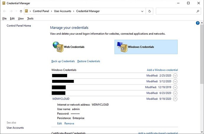

As previously indicated see the Windows Credentials Manger. See if there is a user account created for accessing the My Cloud. You may have to delete that account and any others related to the My Cloud, reboot the computer, then try accessing a Private Share on the My Cloud again using a My Cloud User that access to that and any other Private Share you want to access on that computer.
Example Windows Credentials Manager screen:
In my example the Username “admin” is the admin account on the My Cloud. In my case, that account has been configured to have access to all Private Shares on the My Cloud. If one attempts to use a different My Cloud Username when they try to map a Share (or when a username/password dialog box appears when accessing a Private Share) they may get an error because Windows already thinks it has a My Cloud username in the credentials manager for the My Cloud.
