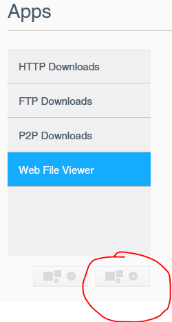

I’ve been able to install 3rd party apps in the past though the http portal on the device. Firmware recently updated on December 21st to 2.11.157. Since then some things have been wonkey. Previously installed apps are still present on the device.
  1. When going to the apps panel I am unable to click on the add 3rd party app button. (I’ve tried Chrome, IE and Edge)

Here is an example. I can’t click the add 3rd party app. As it’s not selectable.
Scratch that I fixed it. Looks like a DNS issue. I updated to google DNS and everything started working. So if your facing this issue try editing the DNS servers to 8.8.8.8 8.8.4.4 and your router IP.
