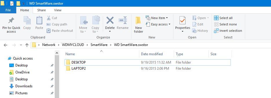

Maybe this will help. I have two computers, my desktop named Desktop and my laptop named Laptop2. Each computer has SmartWare installed on it and both backup to my My Cloud. See example image below.

That clears up one misunderstanding. The default ‘local’ backup goes to the general ‘SmartWare’ share. I was able to validate those backups.

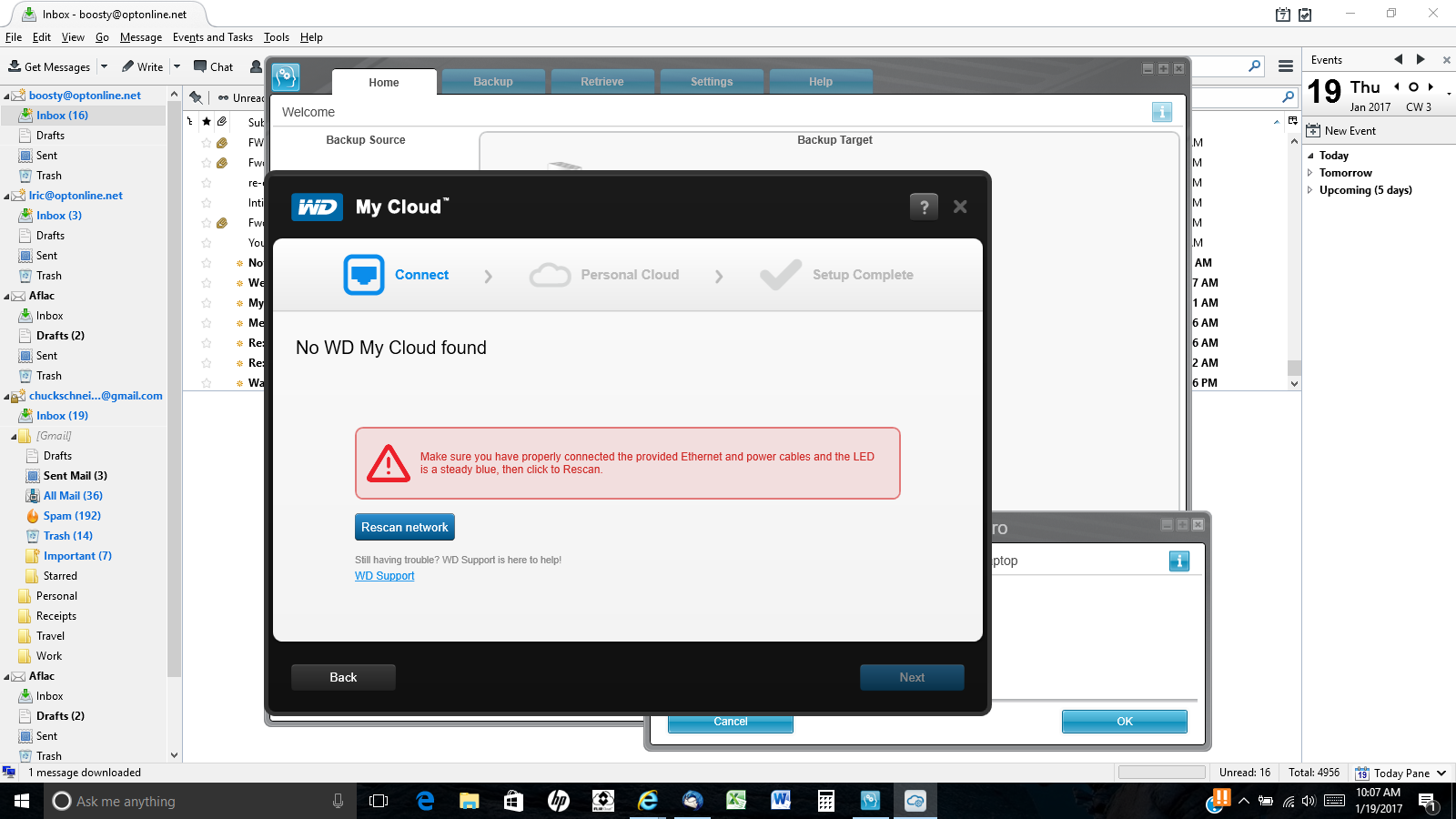

Thank you. Here is the screen shot for the login.
With you screen shot I went into the Configure Cloud Access area and found I may have some setup here to complete. I tried downloading the WDMyCloud desktop application for my PC laptop ( believe it is the same applicaqtion I took this following screen shot from) and was unable to locate my My Cloud device.
Here is what I get from the My Cloud Ap on my laptop, even though I can obviously get to the My Cloud because I am completing backups in the SmartWare share.
