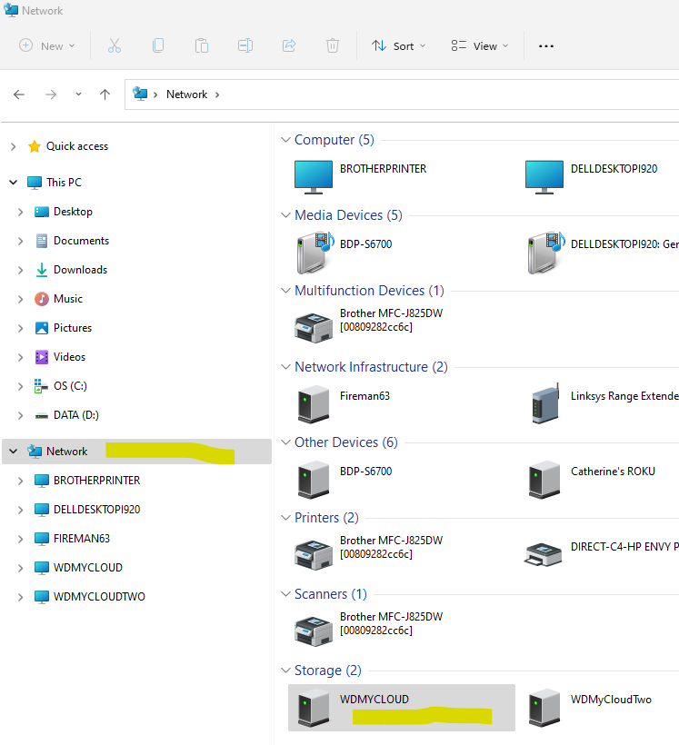

When you open File Explorer and click on your, Network, then double click on your device under Storage what happens? See image below. Click on, tap, or activate image to enlarge it.
