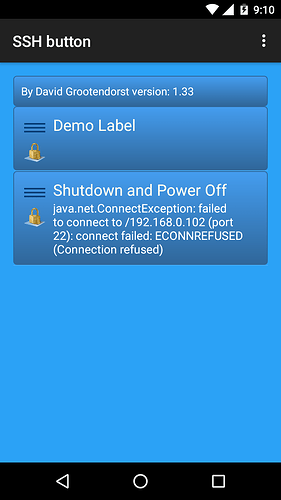

For Android, I use the SSH Button app on my Android phone. Note: Replace the SSH host name with the IP Address of your My Cloud, and replace the SSH password with your password if it has been changed. The following commands may only work on v4.x version My Cloud’s.
Shutdown and power off:
Command: /sbin/shutdown -h -P now
SSH hostname: 192.168.1.10
SSH username: root
SSH password: welc0me
SSH port: 22

Hi. Bennor. I tried the first command and it failed. I entered the command exactly as you suggested and when I tested it, this is the message I received.
And how to determine what version I’m using? I have the firmware “2.11.140”. Is there something that can be revealed from this?
As my post above indicates: The following commands may only work on v4.x version My Cloud’s.
Because you have the v2.x My Cloud (newer generation than the older v4.x version My Cloud) the commands are probably in a different place/location. If you see the Safe shutdown link I posted above one user mentions the proper command to trigger the shutdown on v2.x My Cloud’s: /usr/local/modules/script/shutdown.sh. See the full command at the end of this post. And that same user then confirms it works, that thread continues from those two posts with other discussion that may be relevant including a second user who confirms that SSH command works under v2.x firmware.
http://community.wd.com/t/safe-shutdown/147307/26
SSH command: /usr/local/modules/script/shutdown.sh -h now

I’ve enabled the SSH in the configurations and I’m using the JuiceSSH on my phone to connect to it and send a “shutdown” command.
