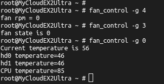

Hi Chris, that information is already available through fan_control
The fact that my fan goes on when my NAS is supposedly idle is the problem, and I’m looking for tools that give me the cause.
The possible causes are, high CPU usage, which we can use top to check that, or the disks are active and generating heat, which is the probable cause, but WD removed the tools that could tell me what’s being done on my disks.
