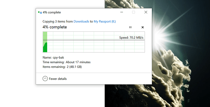

Hi guys, I am using My Passport 750gb external HD and encountered some problems that I hope that some kind soul here is able to help.
Attached above is my normal transfer rate. However, after awhile the transfer rate will drop drastically, sometimes even to 0! When transfer rate is 0, the files will be unable to transfer.
Anyone is also facing this issue? My other WD HDD is not facing this problem. Thanks in advance!
