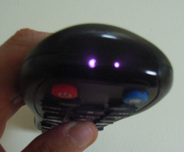

have you checked the remote led sender when it stops working ? (the light signal is invisable to the human eye) so …
grab a digital camera (or smartphone) … look through the view finder … point the remote at the camera … press a button on the remote and you should see a white light flash from the led sender.
This is my WDTV 2014 Media Player remote … it has 2 Led Transmitters (the old Live small remote only has one)
