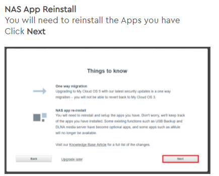

Thanks for the reply. I don’t understand what this means?
NAS App Reinstall
You will need to reinstall the Apps you have
Click Next
What apps is it referring to?

I’m not sure, where are you seeing this? Is it in the Dashboard?
From the instructions on the link, you gave me. It’s like item #5 Things to know One Way Migration.
So is the upgrade to OS 5 for Windows 10 access thru explorer? Sorry for keep asking but it’s got me confused. I just want to make sure of what I’m doing since the warning is a non-returning or undo situation.

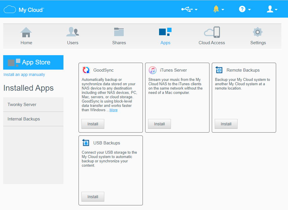

Here is what you are seeing, right?
After you update and get to the Dashboard you will see Apps, install what you want to use. Click on, tap, or activate image to enlarge it.
Thanks. I don’t have any apps installed, that’s where my confusion was.
