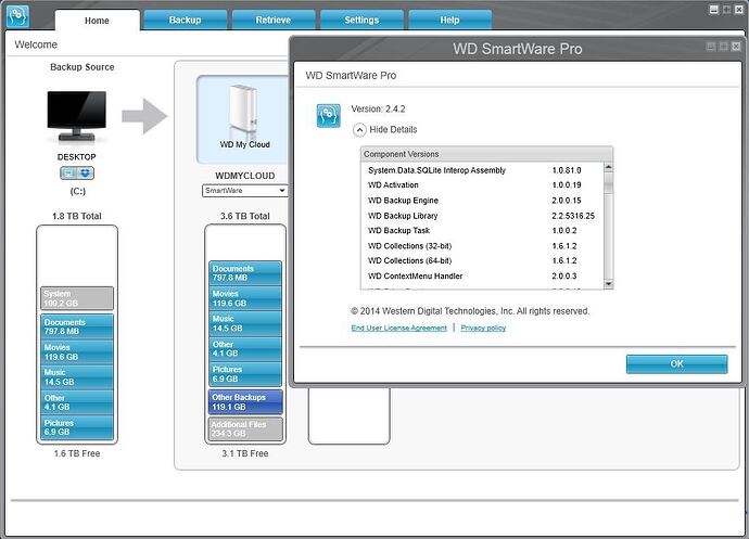

Update: I just updated my desktop and laptop to SmartWare version 2.4.2. See image below.

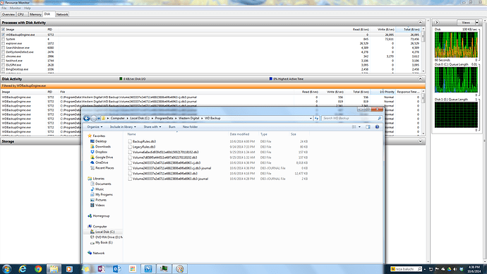

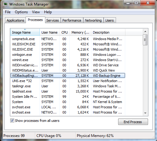

Anyway, what I did to correct my problem in more detail was to choose disable backup in Smartware. Then I had to locate the folder on my system drive that contained the Smartware volume information. On my PC, that was located in a folder called ‘Program Data’ that’s in the root of my C drive. It’s a hidden folder, so you’d have to set your folder options to show them first. Inside that folder there is a folder called ‘Western Digital’. Inside that is one called ‘WDBackup’. The only  files I deleted were the ones that began with Volume. There were four at the time. (I’ll include a screenshot). Now the only problem was that the system wouldn’t let me delete those files because they were in use by Smartware. So I had to pull up the program’s processes to kill them before hand. So using CTRL+ALT+DEL I started the task manager and looked for the processes to kill so that I could delete the files. (I’ll include another screenshot). Keep in mind you’ll want to delete the files quick because the processes will start right back up again. You could try and just kill the WDBackupEngine process- Although I think I had to kill the other WD processes running as well. And I might even have needed to have gone into the services tab and killed them there instead by right clicking on them and choosing stop service. Sorry I don’t remember right now. But one way or the other, you have to stop the Smartware software from running to delete those files. After this, I was good to go. I launched Smatrware again and re-enabled backup. That was it. Just waited for the files to sync up. One thing I might mention to people that have more than one drive or system  backed up somehow- and I don’t know if it’s the case or not because I don’t. Is that if you see completely different volume names in the backup folder, that you might want to check swstor folder that is stored on your backup drive to make sure of the right volume name before deleting. Just thought I’d throw that in there :wink:

Anyway I just wanted to mention that I stated earlier that I wasn’t sure what WD processes or services needed to be stopped in order to delete the volumes in the folder I mentioned. It turns out that the only process that needs to be ended is the WDBackupEngine (You can see it highlighted in the screenshot.). You’ll have to choose to show processes from all users to see that first (at least in my case). And like I said, be quick about deleting the file(s) because it will start right back up again. Keep in mind that I had disabled backup in Smartware first. Now the reason I say file(s) is because I also found that the only volume file that needed deleted to set things right again was the larger file ending with a .db3 extention only. There is another ending in .cj.db3- but I found it didn’t matter if I deleted that one or not. You can delete both for good measure if you like.
