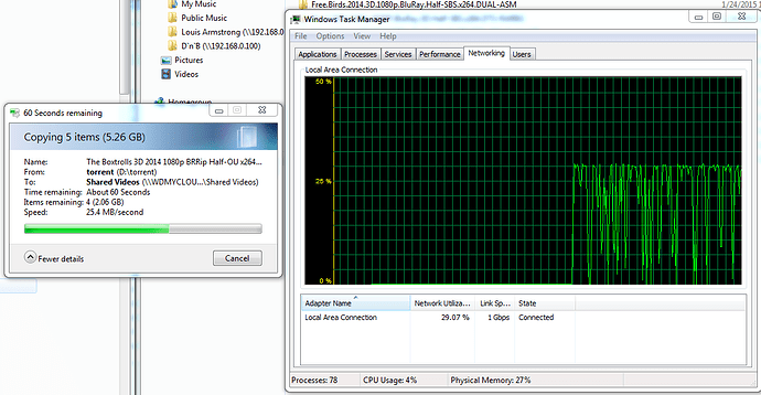

When I try to transfer files to WD Cloud via windows explorer in one point I get 25MB/s after a few minute of transfering connection speed starts to drop and soon breaks. I get windows screen with message that Cloud is not visible (but it is). So I can’ t transfer blue ray movie on cloud.

Can someone give me advice why my connection has this oscilations ? I’m using windows explorer to copy file and after 5 min connection breaks (just for explorer)

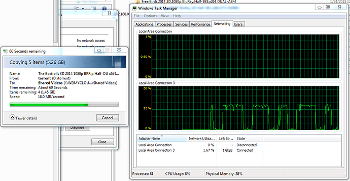

Ok, now have some results
Image below is with router and USB3.0 to ethernet 1Gb/s. Similar results so it;s not network card.
Next image is Cloud direct to PC. Also I have similar results

But from this I can see that is something on Cloud side (or PC)
I have latest firmware.Can it be some settings on Cloud ?

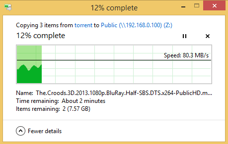

After all this problems I decided to reinstall windows and to put Windows 8 on my PC.  And whola, I have now right results and fast speed transfer.
So it was definitly something with Windows 7, and I don’t have idea what was the problem.
Solution was, reinstall stupid windows.
