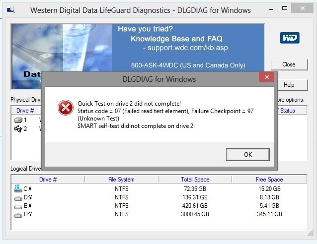

so if i try the quick test its says fail
and if i try the extended test it takes forever
should i do the extended test?
Run the quick test again, then click on the word “fail”.  It should tell you exactly where the problem is.

when i try to do the test its says
06-Quick Test on drive 2 did not complete! Status code = 07 (Failed read test element), Failure Checkpoint = 97 (Unknown Test) SMART self-test did not complete on drive 2!
