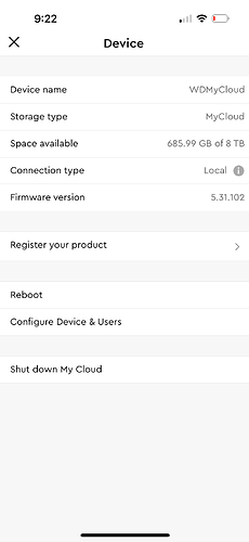

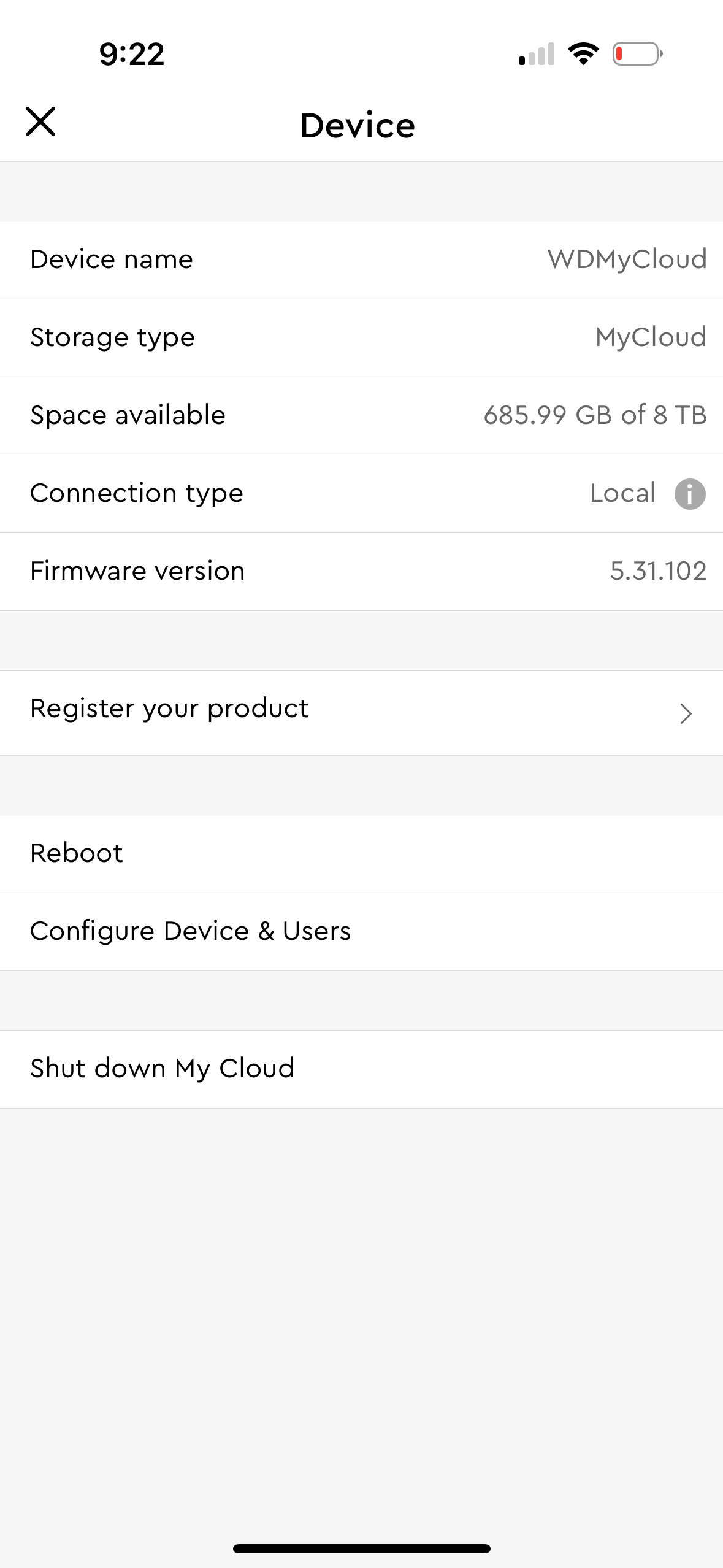

You can turn it off from mobile app, at least in iPhone
