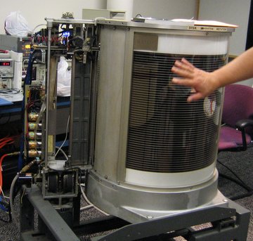

I recall an add for an early IBM hard disk cabinet with a young girl on top. Told me that that unit was huge. Hard to believe how far hard disks have come over the decades
These were the ones that I worked during the 1980s (Control Data):
https://www.hddoracle.com/viewtopic.php?p=5729#p5729
I think they were designed in the 1970s.They weighed about 250kg.
I recall the 30-30 disks on the IBM system 370 that had 30 fixed and 30 removable, but I was still using tape for removable storage before I moved to the PC in starting in 1981. I have one of the original PCs that needed a new BIOS to use a EGA/VGA card.
