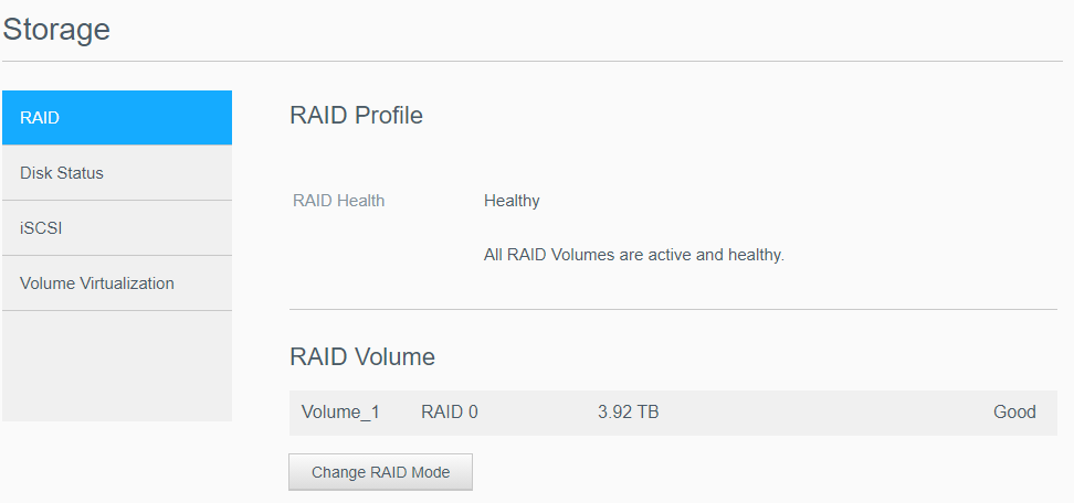

I have 2 x 4TB drives in RAID 0. when I put more than 3.8 tb of files on it the top redlight came on. tests on the drives were normal. I spoke to support who told me to ignore it and continue using it normally. I added more files, the system collapsed and the drive was no longer visible with the top red light blinking all the time. Contacted support who told me to leave the system on for 7 whole days.The fans and disk whirred continuously but Nothing changed the device wouldn’t show on dashboard or the network.An RMA was agreed and it took 10 days to get a replacement. Now I have the same problem. With WD RAIDs can you use only 50% of the space before the system fails? I get 7.5 TB of storage on synology with 2 x4tb drives

RAID0 or JBOD mode which means two data Volumes. It sounds like you may have filled Volume_1 to 100% capacity because the Power LED will become RED at 95%. How are you adding data to the drive? Windows Samba? macOS Finder? Some other software program? Did you check the Alerts? Did you collect and send the system logs to support? What’s your case number?
Isn’t Raid0 inferring “Striped” volume across both disks?
I thought that Raid0 is distinct from JBOD; which would have the disks appear as two separate volumes.

Many thanks. It makes sense. I still dont understand why its saying its 95% full with only 3.9 tb of data on it. Also i did run it for 7 days before sending it back.

the moment i got to 3.9 TB the red light came on even with cloud access off
the dashboard says I 4 tb free
warnings say vol 1 is nearing 95% full
So the RAID 0 Storage limitation appears nothing to have to do with indexing

It definitely sounds like JBOD and not RAID0 configuration.
