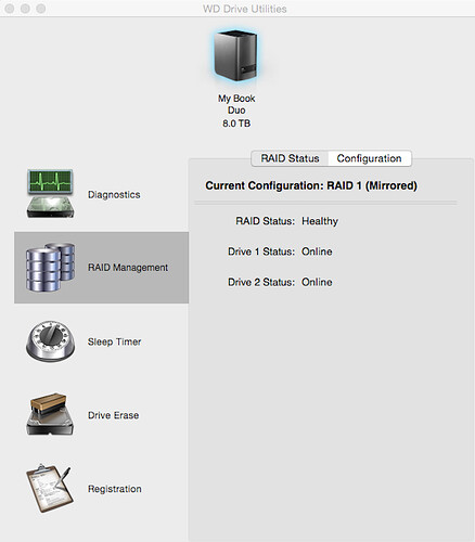

I’m having the exact same issue with my 2011 iMac running Yosemeite 10.10.2.  I have a My Book Duo 8TB set to  RAID 1.  I’ve only had the drive array for about 3 weeks.  When I first encountered the message I contacted the WD Support.  They basically said either one of the drives is going bad, or the RAID array volume created the first time is corupt.  Now all the WD Utility diagnostics show my Duo as healthy.  So I wiped it, loaded the most recent firmware given to me by the support tech (which was the same firmware on my Duo to start with, since it’s brand new and the newest firmware is from Oct '14) and configured it again.  Came down this morning to the same RAID Stripe Failed error message for now the 4th time total over 3 weeks.
I can’t think of anything else to do than to take this back to my point of purchase and exchange for a new one.  I’m not too familiar with RAID configurations and what can cause these failure messages.  Is it truly hardware related, or can there be any setting or config between computer, OS, apps and drive array that can cause this.  The drive works perfectly, and like i said the utility shows it’s healthy, but I can’t take the chance of getting this message over and over and then something catastrophic happens.  I use this My Book Duo to store my Lightroom pics, other massive file folders and my  Time Machine backups.

I’ve talked to WD Support, and even had a desktop share with an analyst.  They feel the issue is not with the unit itself, but rather the issue is in their WD Utilities software, that is throwing the RAID Stripe Error message in error.  He assured me they are working on the solution for this, and will get back to me when they have something to share.  I’ve been using my second unit for weeks now, periodically getting the error message, but the drive is working perfectly.  I have to agree, that the issue is more than likely software, not the hardware.

This entire thread is made up of irritation and no resolutions. Here’s what I know, so you can stop worrying.
  1. This error occurs within WD Drive Utilities on a Macintosh computer
  2. This error only occurs after the workstation has been put to sleep
  3. This error also occurs on non-RAID drives like the My Passport Ultra, which is extra special
  4. You don’t actually need WD Drive Utilities to use your hardware
  5. Delete WD Drive Utilities, you can always re-install it later as needed
Summary: This error occurs because WD Drive Utilities error traps a RAID check function when the computer wakes up from sleep. The error occurs because the USB drive has not yet powered on. It’s a really dumb bug, which WD should be responsible enough to resolve.
