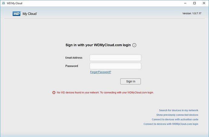

Two more screen captures. If there is no My Cloud on the local network (or its either off or cannot be reached) below is the screen one should see (on a Windows PC) when the My Cloud Desktop program is first run after being installed. If one enters their MyCloud.com user/password information the user should be presented with a screen listing the devices they can connected to (second screen capture below). One would simply click “Connect” on that screen to add and connect that remote My Cloud to the WD My Cloud Desktop program.

it should be noted that the screen captures taken above were on a virtual Windows 10 PC that never had the WD My Cloud Desktop software installed Those screen captures were from the first launching of the WD My Cloud Desktop software at first run post install.

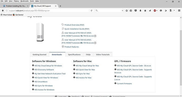

Bill_S, in my case I’m talking about the link for the WD My Cloud Desktop program not being listed (it was at one time) on the product specific download pages like the two shown below. In both screen captures below the Desktop software is NOT found or listed.
