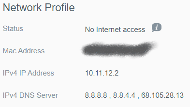

Has anyone experienced, or is experiencing, the current behavior I am seeing with connectivity on the PR4100 under OS5? On the Setting/Network screen, under Network profile, the Status keeps changing about every 30-45 seconds between Internet Access and No Internet Access. I check on the app (iOS) and it bounces between local and relay as well. I also keep losing local access to Plex running on the device, as well as losing access to the device over the Internet. Occasionally, when I try to access the device via the local IP, I get a blank “Hello World” page. If I wait 30-45 seconds, it then allows access to the internal page.

Screenshot 2021-03-27 100129 Screenshot 2021-03-27 101730
The “Internet Access” is only doing a ping to 8.8.8.8.
If it’s bouncing, there’s probably an issue with packet losses

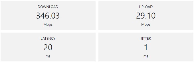

Thanks for the find, it’s not any type of latency or jitter, been running those via Ookla, and they mirror the result that I ran off the tool you shared. Can’t figure out why I didn’t find that message before about the ping to 8.8.8.8. Well, I guess I have to find out more, not sure if maybe there is something the ISP is doing to cause intermittency to Google DNS, router is using the ISP DNS.
Given that, that doesn’t appear to explain that when it shows No Internet Access, I can’t access the internal page and get ‘Hello World’ to the assigned IP, or why Plex is also inaccessible when it’s No Internet Access, as well as the OS5 APP showing it bouncing between local and relay mode and not accessible. Will keep digging.
