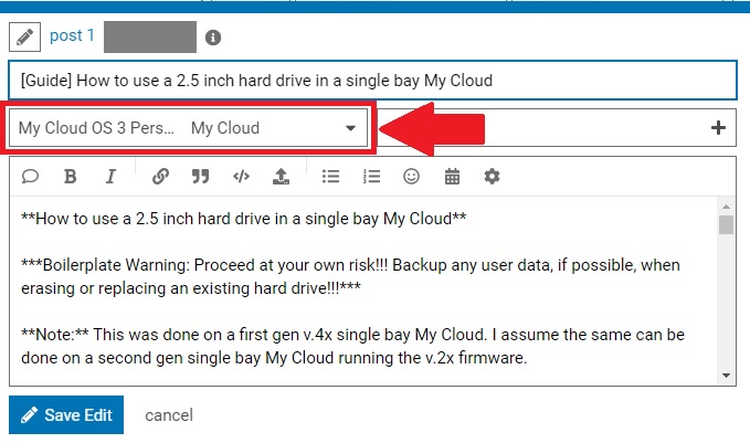

Generally as the discussion starter you can move the discussion thread to another subforum by editing your initial post. (Select the Edit icon below your post.) Then selecting the subforum dropdown box/field and selecting the correct subforum, in your case the OS5 Pro Series subforum. Then select the Save Edit button when finished.
