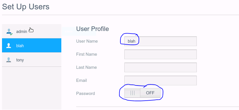

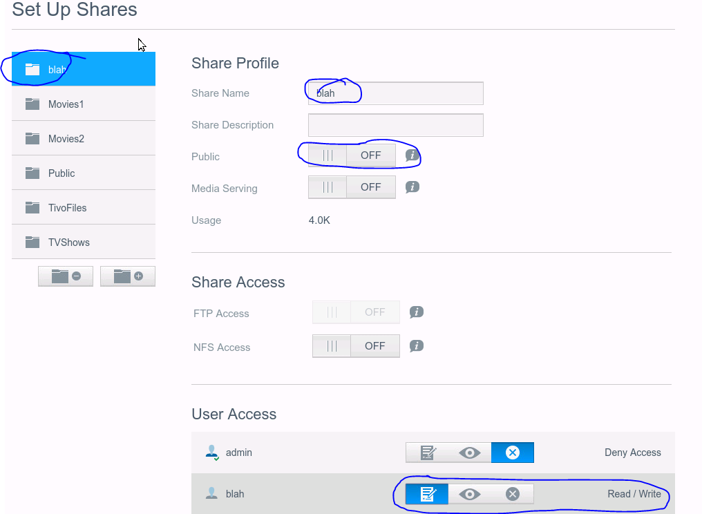

I have configured 2 users/ folders on my MyCloud. One is me. Both users have been given full rights. As “public” they work, as private they don´t. This seems to be a network issue as I am not allowed to access the folders. There is no request for a password, simply denial. The local network is Private and Norton is correctly configured. My OS is W10. I am NOT allowed to manage the folders (not sufficient rights) i.e. I cannot share them with specified (Windows-) users.

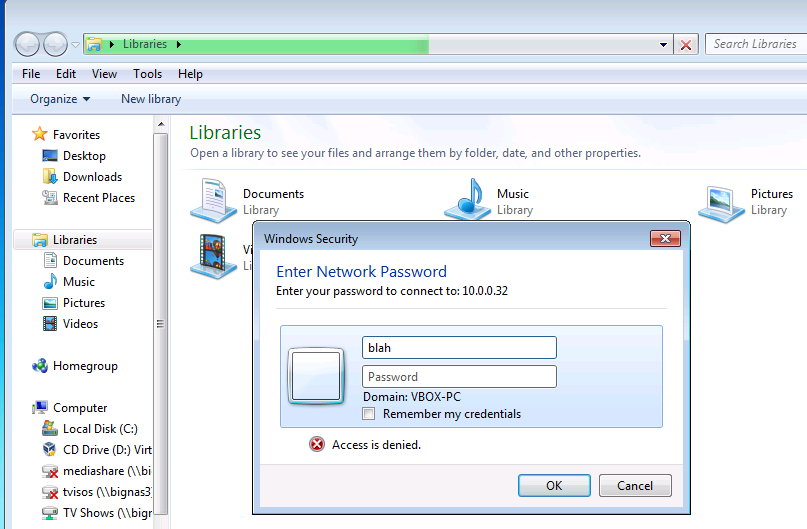

But I can´t access in Private mode. I have now tried to set both folders as Private with full rights for both users. No passwords generated. When I try to connect to my folder the message is that I am not permitted (“contact network adm”) and when I try to connect to the other folder I am asked to authenticate (which I do with my Windows authentication stored for MYCLOUD). Same result (contact network adm). I try to connect directly to the folders by clicking on them.
I understand Tonys comments and agree that it is not a Windows network problem as Public works. The authentication in the Private case (no separate passwords for the resources/folders) however does not work. When setting up the unit I changed “admin” to a separate user name and a password. When asked to authenticate I assume that these are the credentials needed. But it simply does NOT work. HOWEVER if I access the resources via the web (idp.mycloud.com with its separate credentials ) I have no problems which makes me suspect that I have somehow written down the wrong credentials.Is there any way in which I can check this and reset them? Without destoyng the contents of the disk?
Problem solved. Private resources seem to require a non-void password. Having introduced these everything works. WD could have saved me a lot of time by clearly stating this and explicitly requiring it when the status is set to Private.
