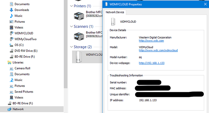

Its a My Cloud 3tb, and the address is correct .
@Ted1 Does the address that shows under Network>Storage>WDMYCLOUD with a right click and looking at Properties match what you have for the Desktop App Icon Properties. See example image below.
