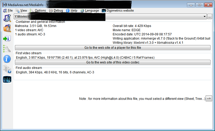

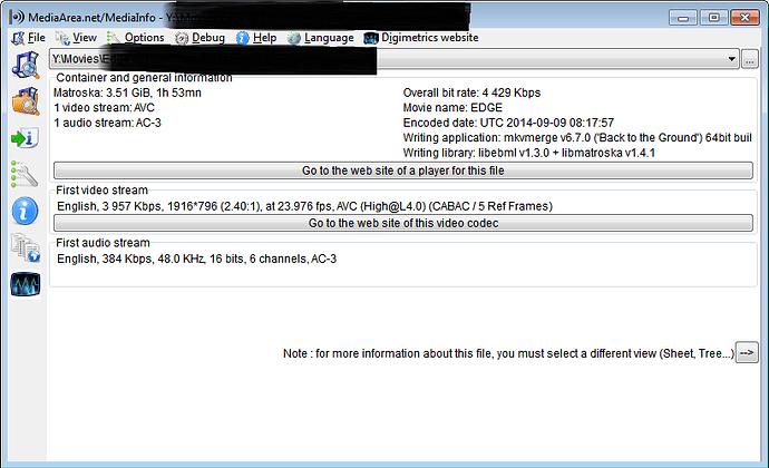

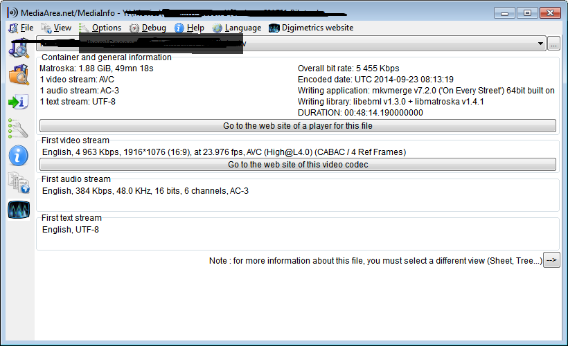

Below are examples of the.mkv files that are working and not working
This is one of the files that is not working
This is an example of a file that does work
