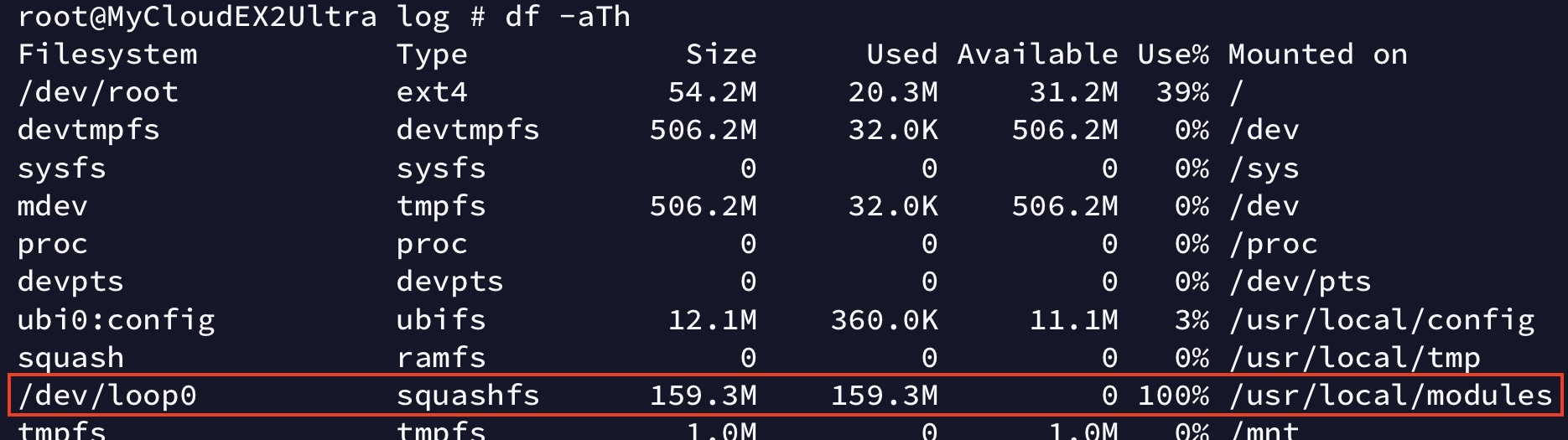

i can’t make changes to the file upsmon.conf, in order to call the script when ONBATT is detected. Reason why i can’t make changes is that the file system is mounted read-only. i would try accessing the files again if i were able to boot the nas from an external flash drive (don’t know how to do that). in that way I could go into the NAS, mount the file system and make changes to upsmon.conf.

the location highlighted needs to be unmounted and remounted read-write … in order for me to make changes to upsmon.conf. before i do that, i just need to review and make sure of the changes i want to make to the file in order to get the NAS shutdown behavior correct.
does anyone know if any of the changes would be overwritten/reverted after a reboot ?
