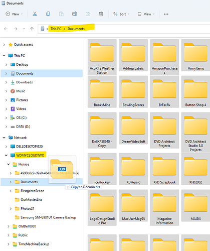

Is your WD My Cloud still connected to your home network? Does it show under Network? If it does you should be able to see all your Shares. See example image below.
Everything should remain the same except that you have a new Laptop.

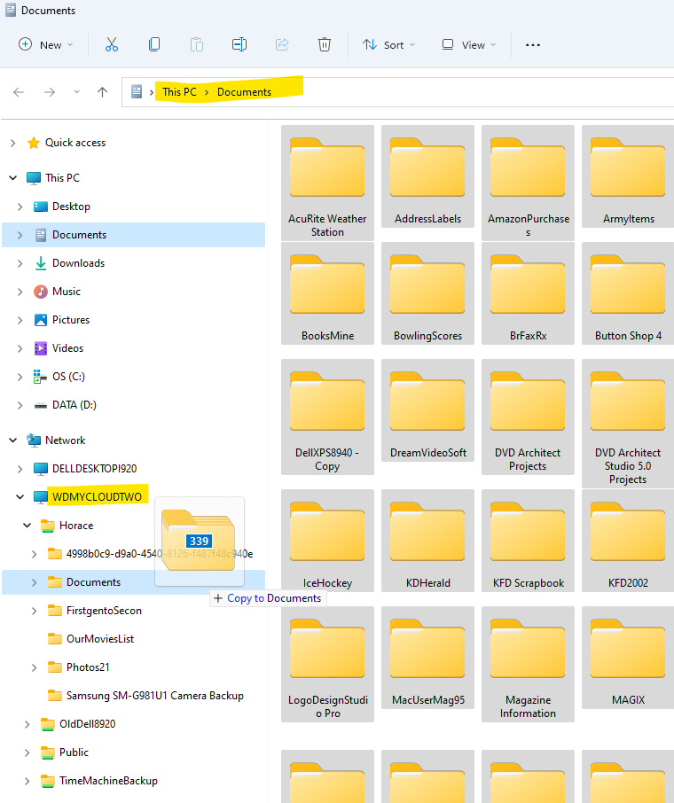

You should be able to perform a drag and drop to move items. See example image below. Click on, tap, or activate image to enlarge it.
