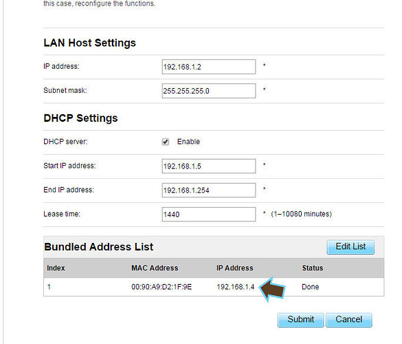

SmartWare and firmware is always up to date. The router assigns a static IP to the drive (linked to mac address), the drive itself is also set to use the same static IP. It is also linked to the same network group. The wireless is also disabled and the laptops access it via ethernet. Network is also working fine - did a simple tests by copying large files from one machine to another without any problem.

Please explain this scenario. if you have used a Static Lease inside your router, the My Cloud has to be set to DHCP, not Static. This issue sounds (again) like a misconfigured IP setup.
Hello Joerg, thanks for reply. Having the drive on DHCP causes issues and can not be accessed. How come all of the solutions online advises, that one should ensure that the drive is set to use static ip instead of DHCP?
Further more I use to have it the other way around - by only setting the drive to static and assigning it a static ip and keeping the router on DHCP. It had the same problem, that’s the reason why I placed a static lease inside the router and drive itself. Still make no difference or am I doing something wrong?
There are two ways to set a Static IP on the My Cloud. The first way (and the best way) is to access the router/gateway administration page and reserve a specific IP address within the router/gateway’s DHCP Server section. On the My Cloud Dashboard, one would access the Dashboard > Settings > Network > Network Services > Network Mode = DHCP. This way the local network router/gateway will always assign the same IP address to the My Cloud.

My suggestion is always to leave the MyCloud setting as DHCP, and use the router configuration to set DHCP infinite lease for it, once an address has been negotiated. It’s less painful than having to set static address on the MyCloud, and DNS addresses, subnet masks, etc.
Hi all, thank you for feedback. I changed the settings back they way it was, as you suggested. In the router I linked the MyCloud drive mac address to a static IP. In the MyCloud console I changed it to DHCP. I can see the drive on the network, but the settings does not seem to have made a difference.
