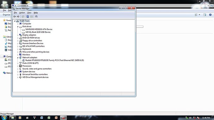

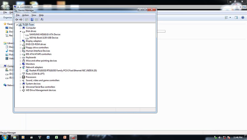

When I connect the WD to my laptop, although I cannot access the WD drive, the light inside the WD drive still turn on, the WD drive still spinning(it keeps slightly vibrating since I connect it to my laptop and only stop when I disconnect it), the icon using for eject the drive still appear in the taskbar and I can eject the drive. In the device manager, the “WD Drive Management devices” also appear.

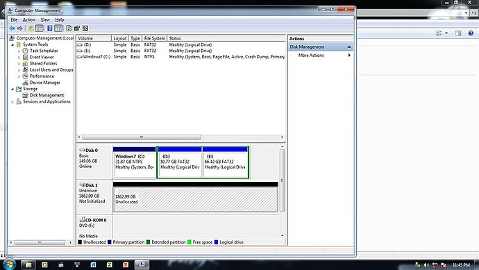

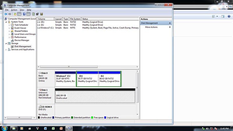

3- Go to disk management, and verify if the drive shows.

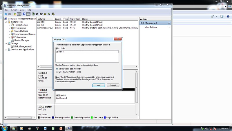

I did as you said and here is what I got:
I did these steps on a desktop. I connected the drive to the USB in the back of the computer case.
Could you tell me what should I do next?
