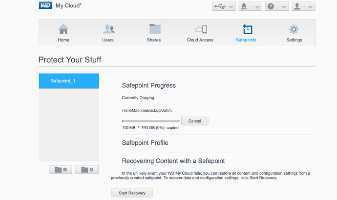

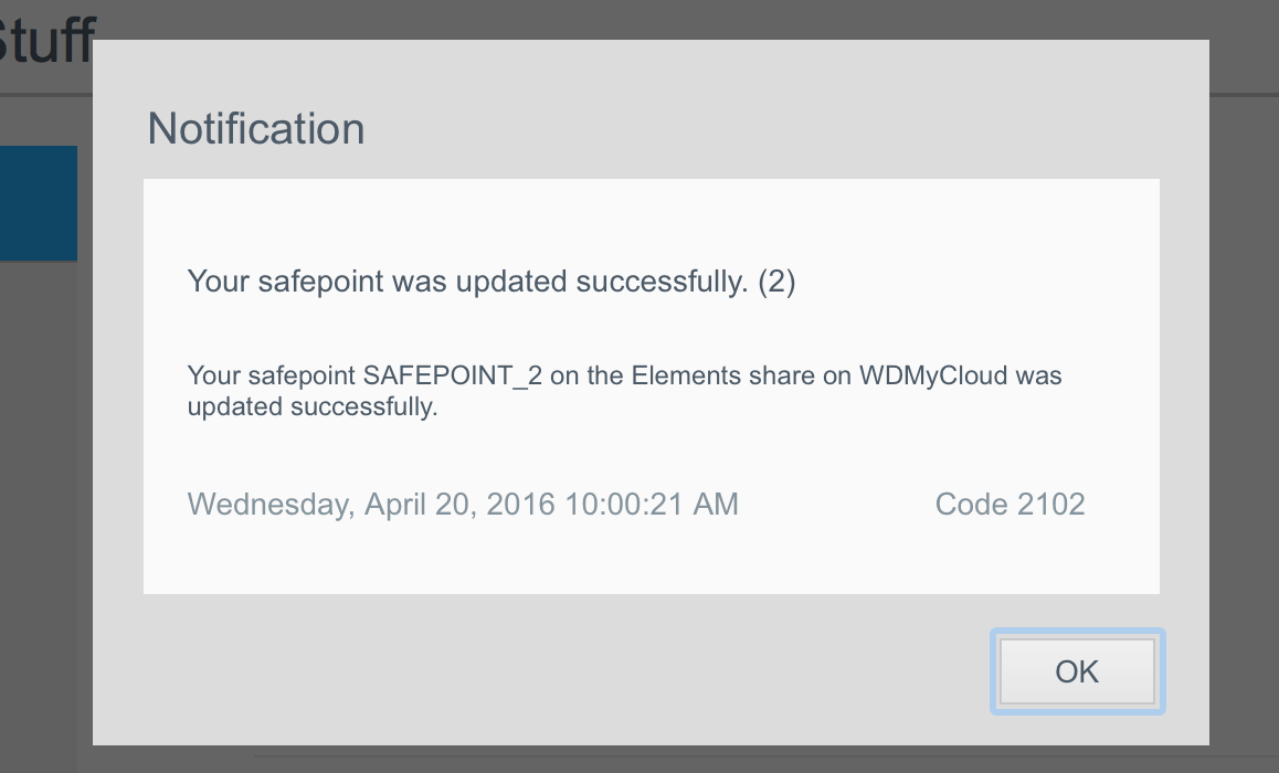

Hi all
Update reported as successful on email alert but dashboard says still copying. Any ideas anyone see screen shots below
Your screenshots show two DIFFERENT Safepoint names; “SAFEPOINT_2” and “Safepoint_1”. Is there one Safepoint on the external USB drive or two.
Also you now have several posts/threads on this one particular issue, you may want to try and confine them to a single thread.
