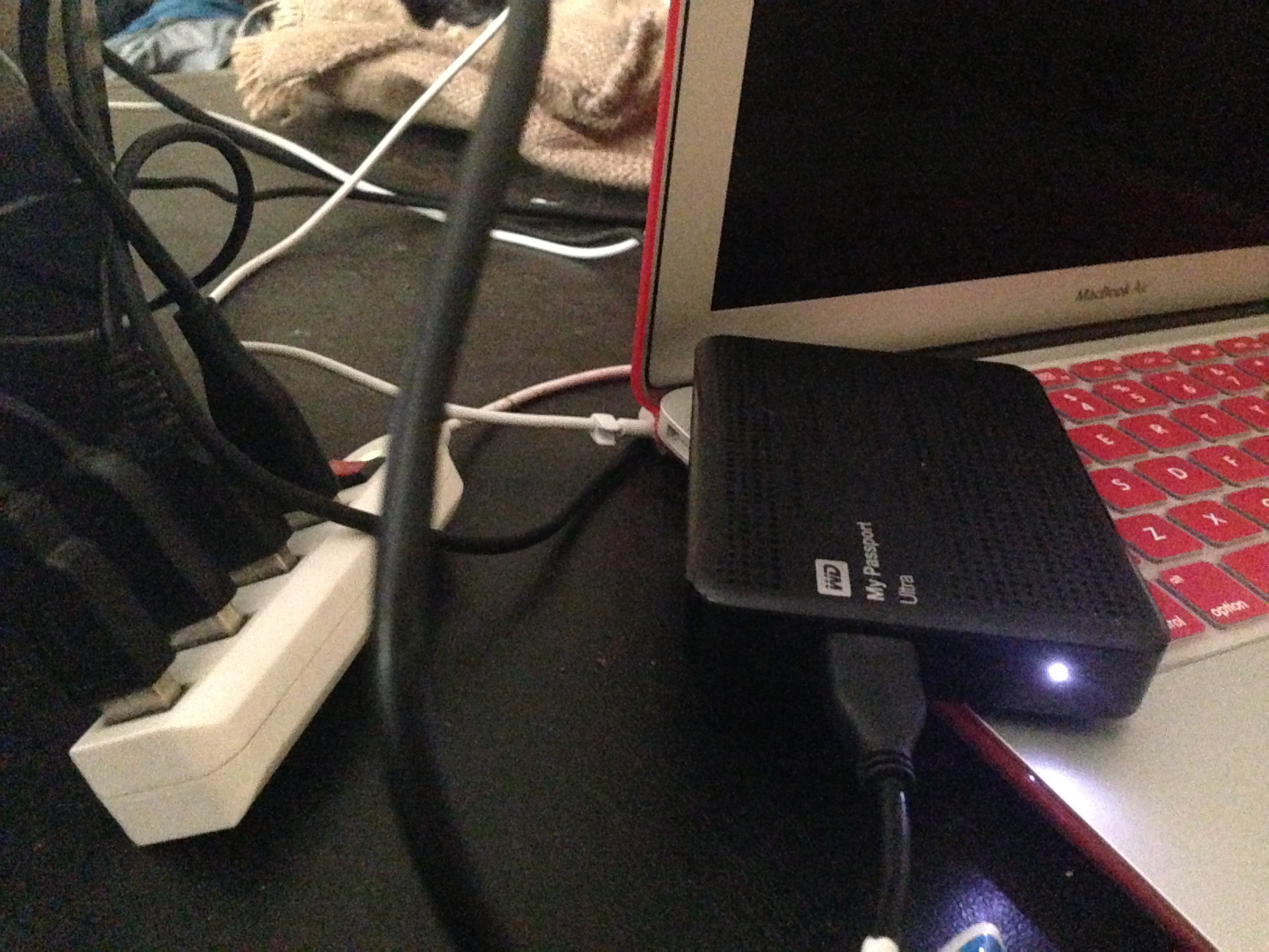

Hi guys, and gals.
I finally have solved the Hard Drive problem. It’s really simple; what I did was connect it through a 2.0 USB HUB, and it is recognized each time I connect it. I guess I’m losing my 3.0 speed, but, who cares? at least it works!!.
I have attached a picture of both the My Passport WD HD and the USB HUB.
BR, MWorks.
