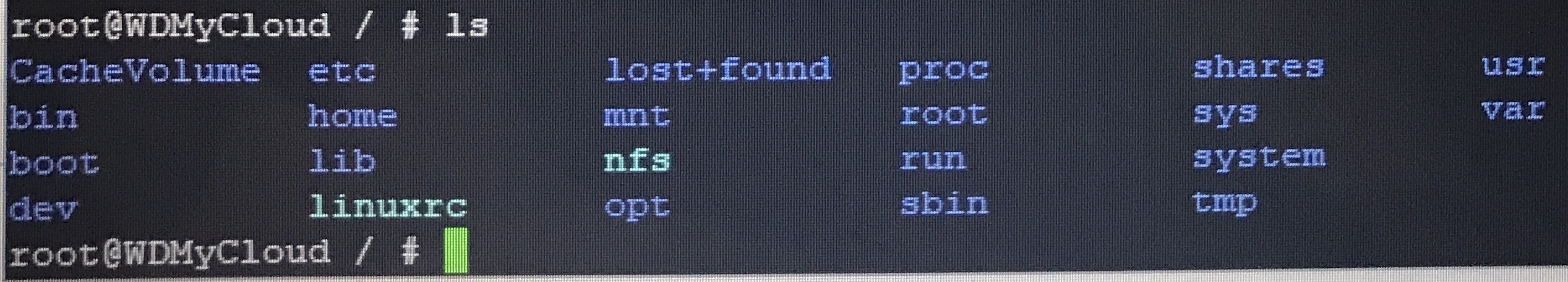

I used putty as command window and reached the root directory of my disc. But, when I type “ls” in order to see the files in the root directory I can only see some system files (please see the picture below):

Most of those are not files, their directories. See that directory named “shares”? Try accessing that (cd shares) and see if it contains the user Shares.
Here is an example from a first gen My Cloud. It shows one logging in, then navigating to the root level, then accessing the shares directory. The second gen may be slightly different at the top root level. In the shares directory are four shares. One Share I have redacted (its a User Share) in red, the rest are default My Cloud Shares.
puttymycloud
Thank you very much. I am now able to see my files in “mnt” folder. Using filezilla, I copied them all to my local disk over the night. The copying has now been completed and I am able to save my files.
