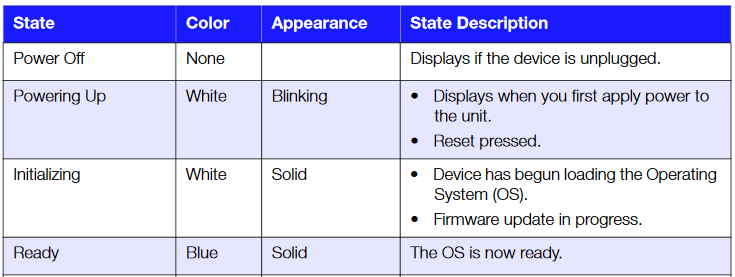

Here are the phases of LED on My Cloud 04.04 firmware.
The white LED could be the file system check running and could take a bit of time.
Best case if not to power cycle the unit.
Worst case, the OS is hung
