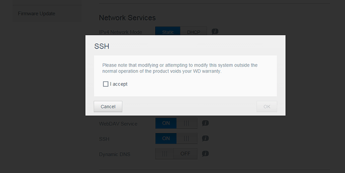

Unfortunately SSH is not working. I just had a thought, if i connect the cloud directly to my PC via a Ethernet cable do you think i would be able to access the file system?
