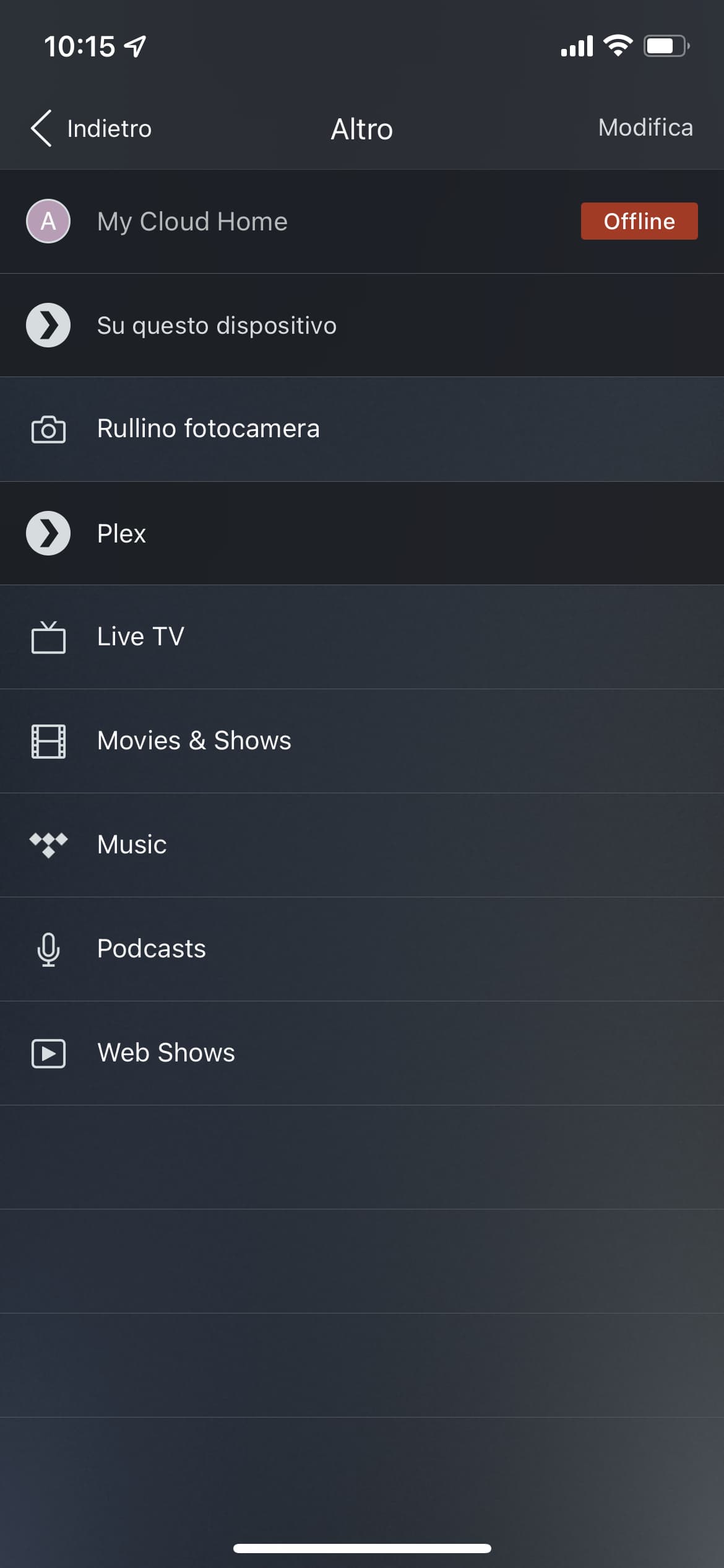

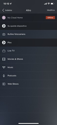

I am using the Plex app on IPhone and now My Cloud Home is Offline.
I am using the latest version of Plex app installed on 30-september.
Before I was able to see the content of My My Cloud Home from Plex app on IPhone.
The same problem also on Samsung phone.
