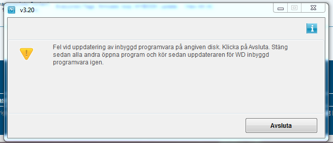

Anyway, I choose to update the firmware, the disc got kicked out from (sas/disc mode) to something I guess are a write/update mode for the FW (image 1 below) and then the progressbar started to move, problem being that it doesn’t really seem to do anything, I have no % meter and it only maxes the progressbar, then it starts over, and over, and over.
Image 1
Hopefully the updater haven’t yet to write any data and hopefully I should be able to just powercycle it, but I thought I’d ask here before.
So this is what the application looks like now, sorry for the Swedish but what it says are.
Update you built-in wd software
The update of the discs firmware are running. Do not disconnect either the usb nor the power cable during the duration of the update.
Mybook Elite -------------------------
[Image deleted - Trancer]
Sooo, what to do?

Update 1.
So I left the computer running for a few hours to come home to this:
"A error has occured while updating the built-in software of the specified drive. Close
all running software and then try to run the updater for built-in software again"
I did as the updater asked me, but without any change, and since the software don’t really seem to be able to update the software, but i keep clicking next until I get stuck in the same “progress bar loop” as in the first post.
