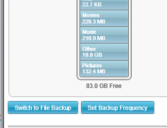

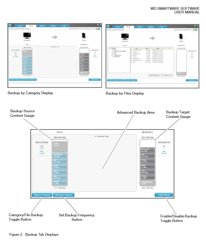

Change from Category mode to File mode. This is a button at the lower left on the Backup tab of SmartWare.

This is really puzzling. I am not currently using Smartware, but I downloaded the version from the link you posted and installed it. In the course of the preliminary configuration screens, after the install completed, I was offered the choice between File and Category backup. I let it go through as Category. I then called up the program from Quick View, and went to the Backup tab. Once again, I have the buttons at the lower left.
