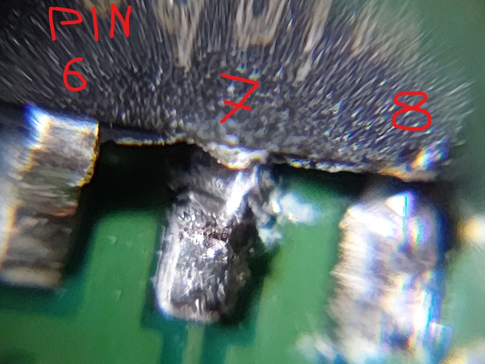

Solved!
Thank You GetDataBack, very much.
The solution in the 2019 model (the one with squared design) is very similar: instead of to cut only pin 8 of the chip Winbond, You have to cut pin 7 and 8.
sorri for the bad quality of this macro, I’ve shot via lens.
Thanks for the additional information!
