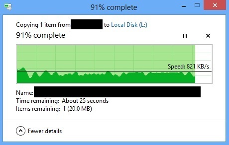

Problem 2. Slow transfer rate to my 1.5TB external Hard drives. It sometimes go from 40MB/s to 500kb/s and then 0kb/s. I have tried connecting externally and internally, formatting it each time. Tried formatting using software (WD quick formatter,Easeus) , computer format (quick and long) and boot format, it still remains the same. I did a few pages on this problem and some people said, WD secretly put a rookit in my external, is this the cause?

Figure 2.1 Slow transfer rate

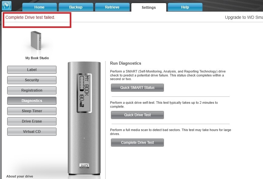

Figure 2.3 Test fail, 2 out of 3. Cant format, it ended up failed.
Since the test failed, the hard drive would appear to be faulty, if it’s possible, you can try using another USB cable. If the problem continues, you will need to replace the hard drive. Check the link below for the steps to check the warranty and create the replacement number (RMA).
