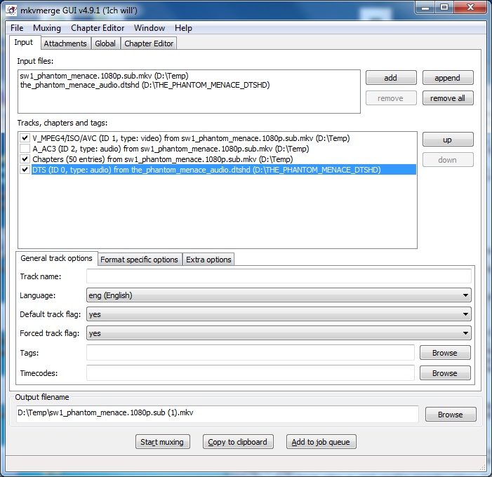

Personally, what i would do … as a “quick” attempt to fix the file (sure, i know … it plays fine on your PC which almost anything does … even corrupt stuff. WDTV is different, it’s a Hardware decoder and is pretty fussy)
  1. Download MKVToolnix ← click it
  2. And using MKVMerge GUI from that install … “Remux” it to MKV … this does not re-encode the file, so you won’t lose any video or audio quality
  3. It will probably take at a “guess” 15~20 Min ?
  4. It will most probably report GOP Headers Errors … have had this with mpg-2 dvr stuff before … just ignore the errors and try playing the newly created/muxed mkv file
example screenshot of what MKVMerge looks like
(just drag’n’drop your VIDEO into “Input Files” then click “Start Muxing”)
