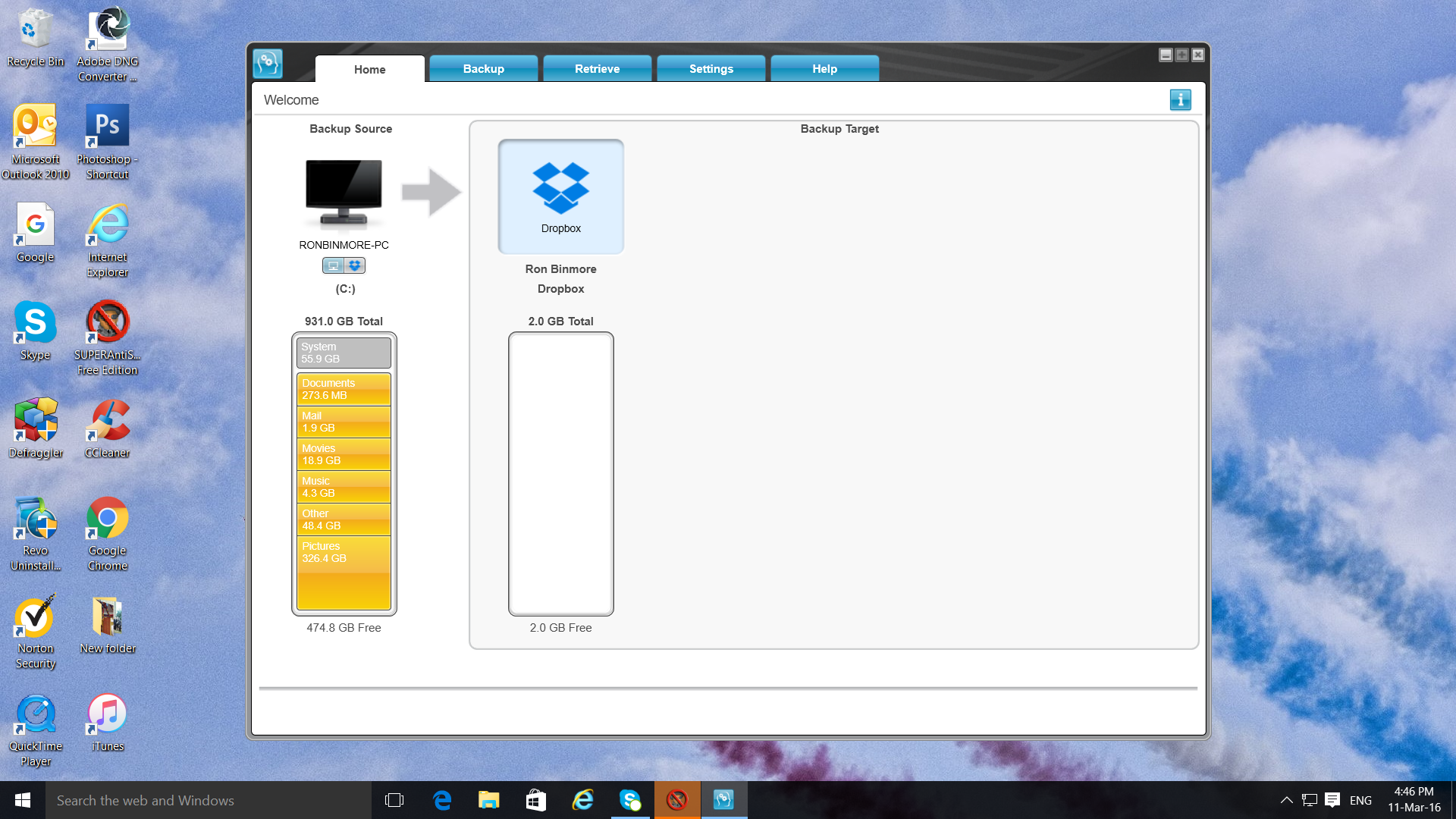

This is the screen I was trying to describe…
Ron

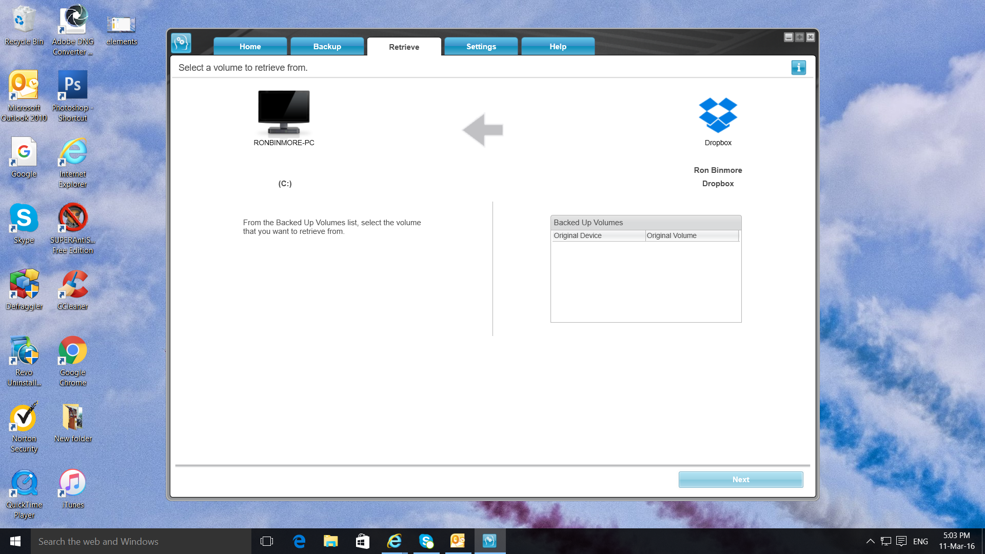

How can I send you some screen shots of what is going on please??

These are the two screens I get with the unit plugged in and turned on. I am not sure what I have to do to retrieve a file if I had the need. Apart from that, I think I have a grasp of the nettle.

I’ve read a bit more of the manual. I noted that the Elements drive wasn’t mentioned in the list of supported WD drives, and that you have to upgrade to the Pro version of the software to make it work. This is confirmed on p32 of the user manual.
If you haven’t upgraded your software to the 30-day trial of Pro, then I suspect it simply won’t show your Elements drive, or your IOMega drive. That’s why it’s only showing the Dropbox image. [edit: hmmm… Pro is needed for Drop box support, too, so you may have installed it…]
I note that the Dropbox logo in your screenshots doesn’t have a little key symbol beside it, which means that you must have created, and logged into a Dropbox account…
Since your source data includes more than 300GB of photos, and you only have 2GB of Dropbox storage, the backup tool may have decided not to do anything.
So it looks like you would have to upgrade to SmartWare Pro, and pay for a licence, or look to another, free backup tool. I use FreeFileSync:
The interface looks à bit daunting at first, but, once you get the hang of it, it’s easy to configure, and very versatile.
