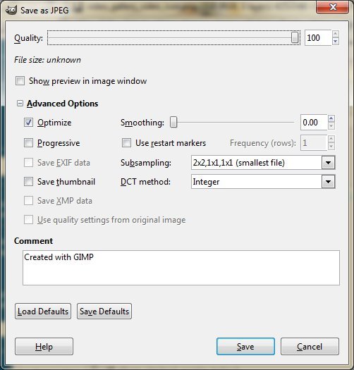

Here’s some that you can try, and has worked for me in the past.  Open the image in Gimp/Photoshop (if you don’t have either Gimp is free), then copy the image, Ctrl>C, then select File / Create / From Clipboard.  Then save the new image as “yourfile.jpg”.  When the “Save as Jpeg” box comes up, make sure you save it like this:
i use photoshop cs3, ive tried every save option available, removed exif data and the thumbnail is still poor, i can upload one if you want to check it out for me

But as far as saving the file, and I don’t know if I made it clear or not, but what I was trying to tell you to do is that you actually need to open the image in photoshop, then copy the image, open a new empty photoshop window and paste the image then save it.
Just saving the image will not fix any defects, copying it then pasting it in a new window is like creating a new image, if that makes sense.
