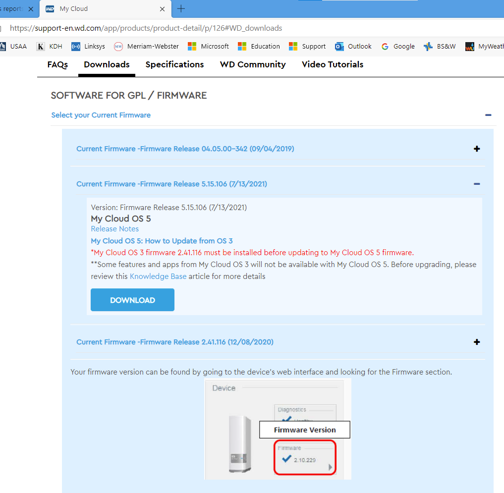

Is this where you downloaded from? See image below and I will place a link below the image. Click on, tap, or activate image to enlarge it.
My Cloud (wd.com)

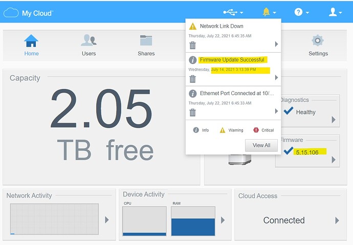

Where did you place the file when you downloaded it? I always place it on my desktop. I then open the Dashboard and do the Manual install/update choosing the file I placed on my desktop.

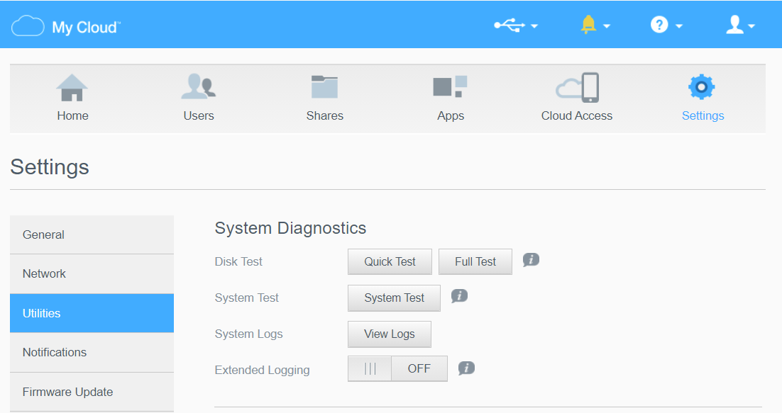

Have you already looked at this?
