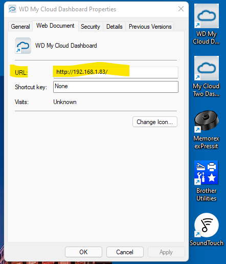

These are the steps I would use. With your My Cloud connected to your router as shown in the User Manual, reboot your router. After it reboots check to see what shows under Network. See example image below of mine on my router. Below that image see what is showing under Network for my desktop computer.
To open the Dashboard, use the address for your My Cloud. If you know how and must, look at your router to find the address. Be sure in Settings that internet connection is off!
To see your shares use the address shown below. See example image below.
