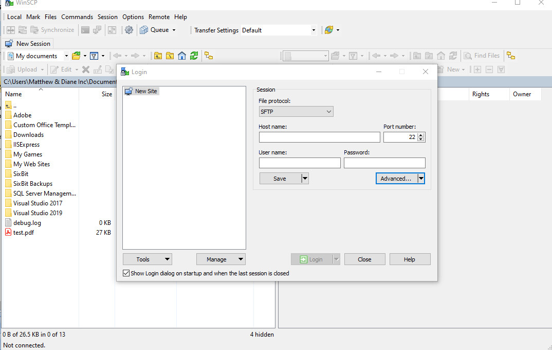

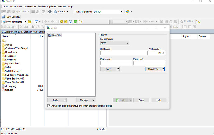

I downloaded and installed the WinSCP. I am new to this stuff. Can you show me how to fill out the login window? What do I choose for the file protocol? Host name, port number? Thanks
You will need to write down the user name and password (if any) that is shown when you enable SSH within the My Cloud Dashboard > Settings > Network page. The following WD Knowledge Base article (found using a search of the Knowledge Base, link top of page) has more information, including directions, for programs like WinSCP and Putty.
