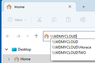

If you own a 1st generation WDMYCLOUD have you set it up for use on your home network? If you have it properly connected as shown in the User Manual try \\WDMYCLOUD.
