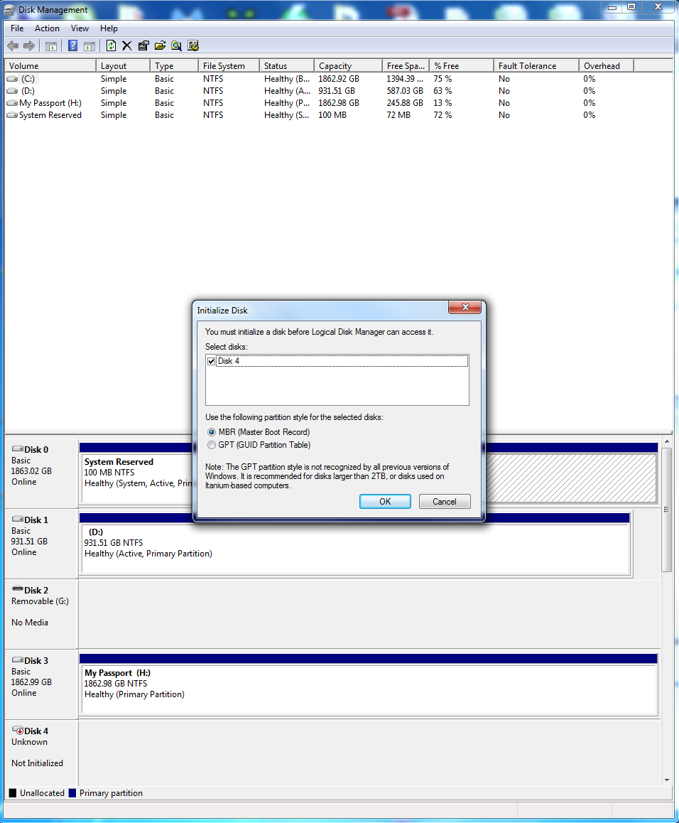

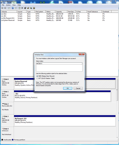

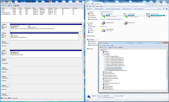

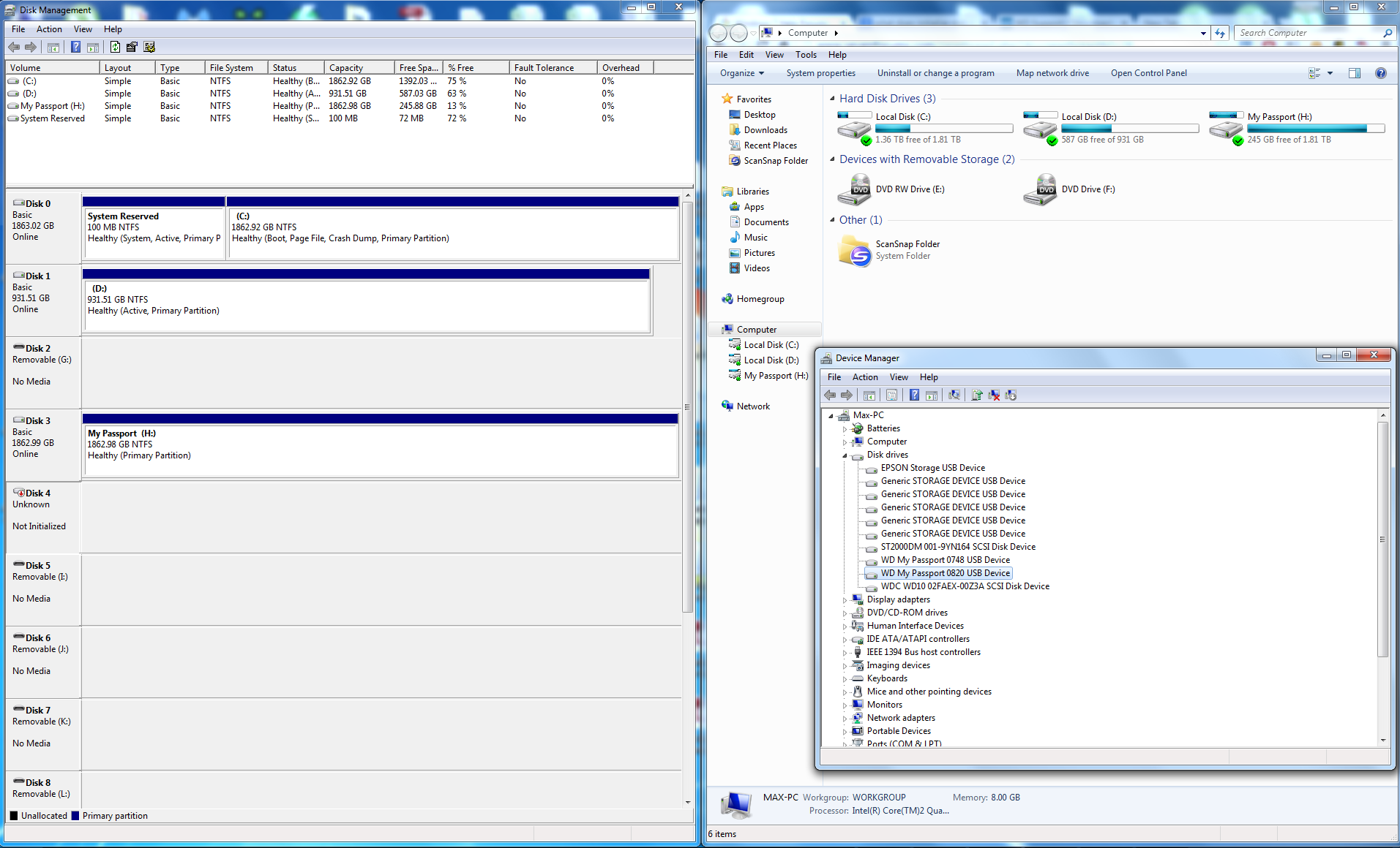

I plug the drive into the computer. It does NOT show up under My Computer. It DOES show up in Device Manager and Disk Management. See the screenshot attached.
Drive C is an internal boot drive. Drive D is an older internal drive with files from before starting anew. Drive H is another WD external drive (unaffected by BSOD). The drive that isn’t working was (N: ) before I believe.
In Disk Management the drive comes up as “Disk 4” and in Device Manager it is “WD My Passport 0820 USB Device”.
If I connect the drive to another computer, it will install the driver software and the same issue will occur. If I “uninstall” the drive, it will reinstall the driver software and still same issue.
The LED light is constantly on, but it does NOT feel like the drive is doing anything.
When I open “Disk Management” is prompts to “initialize” the drive. Another screenshot attached.

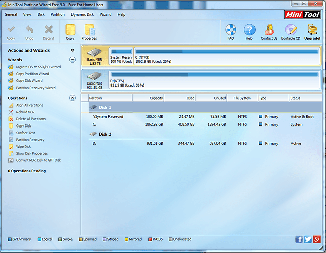

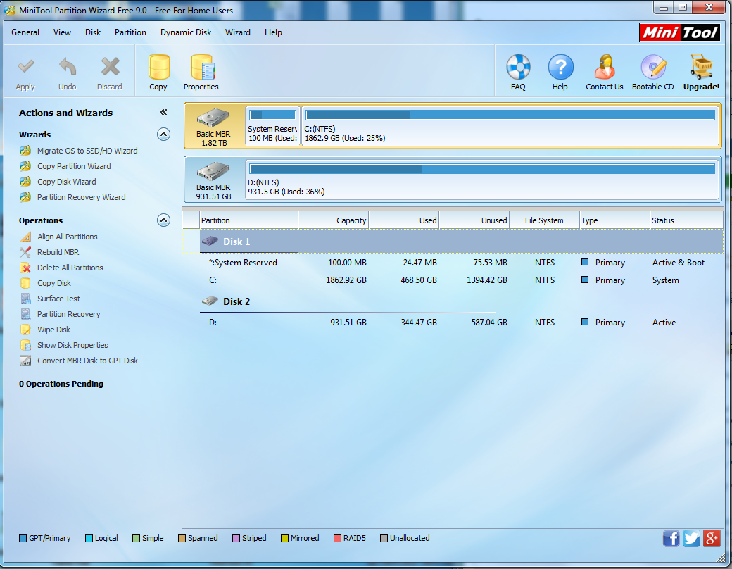

Reading several threads with similar issues lead me to install “MiniTool Partition Wizard”, but the drive doesn’t show up in that program. See screenshot number 3.

If the computer is asking you to initialize the drive then it means the partition is corrupted.  If you proceed and initialize the drive you will delete all the data stored on the drive.

I have tried using various Data Recovery software and none of them seem to pick up the drive. Disk Management and Device Manager do, along with WD Data Lifeguard Diagnostics (shows it as 0 MB) and HD Sentinel (but shows no info).
