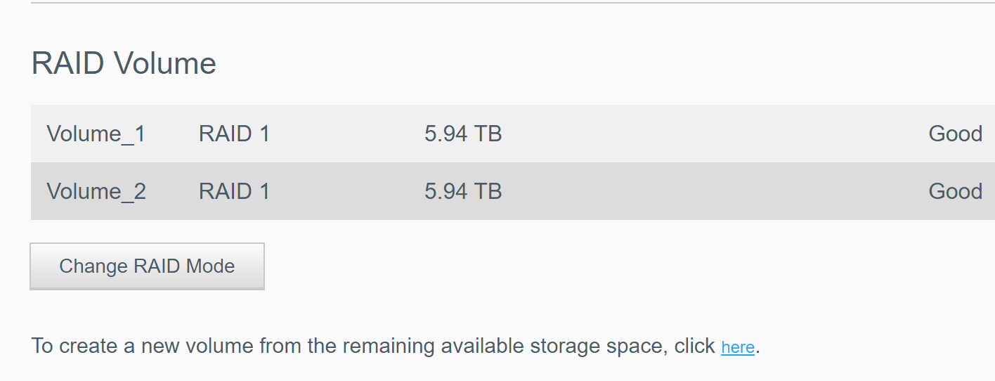

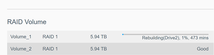

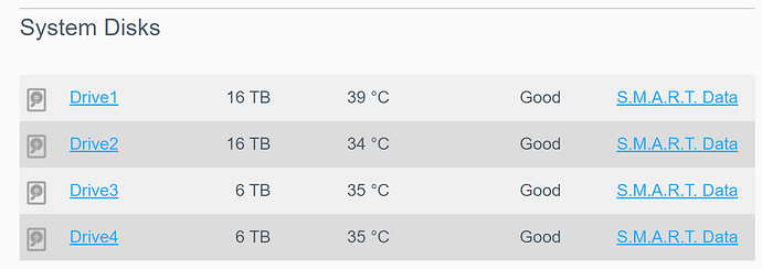

Right - my two 16TB drives arrived to replace the two 6TB drives in RAID1. I figured it was worth a try to swap them one at a time and rebuild, in the hopes that I would acquire a 16TB RAID1 pair. I duly swapped the first - and after about 12 hours I had a good array - still at 6TB (of course - the smaller drive). I swapped out Drive 2 and that is rebuilding, but it still says 6TB despite there now being two 16TB drives. Have I missed a trick? Will this show 16TB after the second drive is complete or am I going to have to bite the bullet, stream the whole to a scratch drive and format this pair separately?
Further to the above, the rebuild is duly complete, and it still shows only 6TB available - although a magic new link has appeared which presumably will allow me to create a “Volume_3” with what’s left. It’s getting unnecessarily complex with Volumes, but by moving things around I can do this and ease pressure. However, I’d prefer a larger single 16TB volume to make life easier if I have a disk failure in the future. Suggestions gratefully received before I bite the bullet and create a further volume.

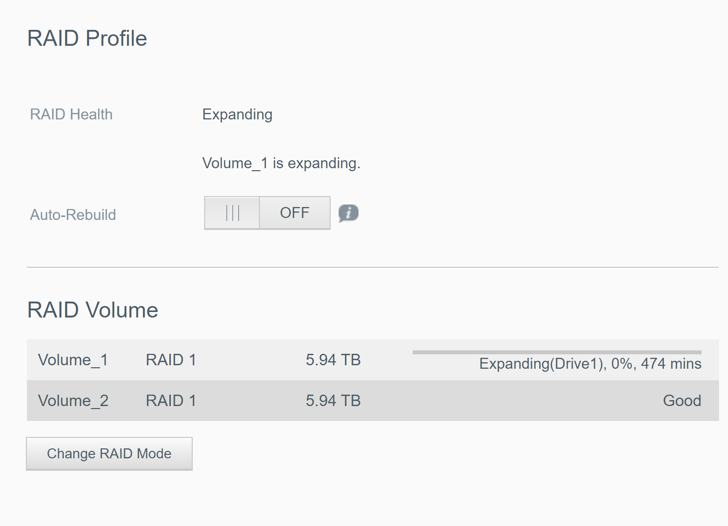

Answering my own question - I got adventurous and dared to click “Change RAID” - and made my way to an option that allowed expansion of a volume. It looks like I could have done this as part of the disk swapping if I’d known - but no matter - in a short (!) while I’ll be where I want. If moderators want to split this into two topics for others’ benefit feel free.
Glad you got it sorted out.
In actual fact that expansion was a ghost. Lots of whirring and it truly went through the motions, but after two rebuilds and about 14 hours… back to square 1. I opened a support case - and then followed the procedure in Is deleting a volume possible? - #4 by RogerJP
